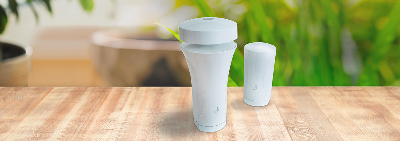

The Smart Weather Station is a dynamic modern piece of technology, always getting better with every app release and automated firmware update. Use the Smart Weather app to walk you through setup and configuration.

The HUB is designed to plug into a power outlet inside your house. We will supply a USB power cable for international compatibility.  The AIR & SKY run on AA batteries. We strongly recommend using Lithium (not alkaline, not lithium ion) as they perform much better in variable temperatures.  AIR uses four AAs, and SKY uses eight AAs.  Both AIR and SKY are meticulously designed to consume a tiny amount of power allowing for super long battery life.
AIR & SKY communicate with HUB via powerful sub-gHz telemetry radios. We have tested the radio signal over 300 meters (1000 ft+) in a clear line-of-sight. All situations differ with local obstructions like walls and power interference.

We’re all about good data….because let’s face it, bad data is misleading. That’s why we have spent considerable effort sourcing and testing high-quality sensors for every device we produce. Combined with innovative technologies like our proprietary sonic anemometer and haptic rain sensor, our devices are every bit as accurate as scientific weather stations that cost 3X the price. See our sensor specs on the previous page.
Better siting, better data. In order to accurately measure wind, rain, and UV you need to place the SKY in an open area with a clear view of the sky above (like on your roof). As you can imagine, placing a temperature sensor in the full sun presents issues. That’s why we made the AIR a separate device to be placed in the shade — more accurate data.

AIR is designed to be placed outside in full shade. The small wireless form factor allows you to move the device easily from season to season as the sun sun angles change. If you cannot find full-shade, we recommend housing AIR within a solar radiation shield to avoid temperature spikes caused by direct sun exposure. AIR should also be placed away from electrical interference like major appliances, power lines, outdoor speakers, or other electronic devices that could potentially cause interference of the lightning detector. Finally, it is best to situate AIR in a vertical upright position as the lightning detector antennae must be vertically oriented to perform as designed.
SKY is designed to be placed in full sun, with a clean wind fetch. Ideal location is on a pole clear of physical obstructions that might impede wind flow.  The LUX sensor on the top of SKY is design to be placed with a clear view of the sky. It is not imperative to mount your SKY way up on your rooftop unless you’re really into wind measurement. Also, make sure to eliminate any vibration in the mounting to avoid false rain reports.
If you must place your AIR in a sunny location, make sure to house within an adequate solar radiation shield and preferably exposed to the breeze. There are solar shields available on Amazon: search “solar radiation shield”.  We’ve test the Ambient SRS100LX:  http://a.co/fu9505i  and the AIR fits snuggly inside. All that said, the AIR works best without an enclosure and placed in the shade.
The SKY has a couple mount options. The first option is a standard 1/4-20 mount commonly used for cameras and small electronics. The second mount is designed to fit n top of a pole with an outer diameter of 1.315 inches, or 33.40 mm. The specific standard is known as “NPS 1” in the US (and Canada?) or “NB 1” in the UK. In most of the rest of the world it’s also known as “DN 25”. It should be a very common pole size everywhere. In the US it’s sold at DIY stores in various materials-if you ask for a “one inch” pole.

SKY houses a sonic anemometer in the top of the device. The SKY measures wind speed and direction based on the time of flight of sonic pulses between pairs of transducers. This allows for a high degree of accuracy especially in variable wind conditions.  For more information see Wikipedia on Sonic Anemometers.
Good question! Our proprietary sonic anemometer actually samples wind every 1sec, then reports the 3sec average to the hub. The hub makes the 3sec data immediately available to the app, via UDP multicast, and via BLE spec. The hub then calculates a 1min average (+ lull & gust) and publishes that data to our servers in the cloud.  This scheme allow us to sense and report detailed nuances in the wind field. We have been evaluating user-configured update intervals — but it’s not available in our software yet.
Yup. Pretty cool, huh?  The AIR actually detects cloud-to-ground AND cloud-to-cloud activity. Our sensor detects electrical transmissions from lightning activity up to 40km (approx. 25 miles) away and gives an estimate of distance. Humans can typically sense lightning only up to 25km away. The sensor algorithm is even smart enough to reject man-made signals such as microwave ovens and motors.  That said, it’s important to place the AIR away from electrical disturbances for best performance. The maximum detection efficiency at 5km is about 40%, at 15km ~35%, and at 40km ~18% or so. Please note that the sensor is an early warning system designed to track the head of the storm, it is not necessary to capture every single lightning strike. It is enough to capture some events to get information on how far the leading edge of the storm is away from the sensor’s position. The system is based on statistical analyses of lightning strikes and is thus not comparable to expensive lightning measurement equipment.
SKY uses a patent-pending haptic rain sensor in the top of the device. Using a combination of pressure and capacitance, SKY measures and counts each falling raindrop. Algorithms exclude things that are not rain (like the rumblings of a passing train or Harley). This allows SKY to report the instant rain begins falling, the current intensity, and the total rain accumulation over time.  Accuracy compares to a large tipping bucket, but does not get fouled with leaves or bird poop.
